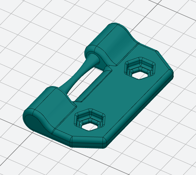

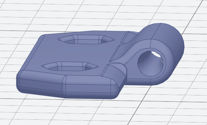

Designed a 3d printable hinge to be compatible with grid beams, where the entire hinge (including the “pin”) is printed altogether as one.
:star2: View the Replicad 3d model (and export 3d-printable file)
:technologist: View the Replicad source code
My 3d printer is in disrepair, so I haven’t been able to print and test the model, but I’ll update when I’ve been able to print.

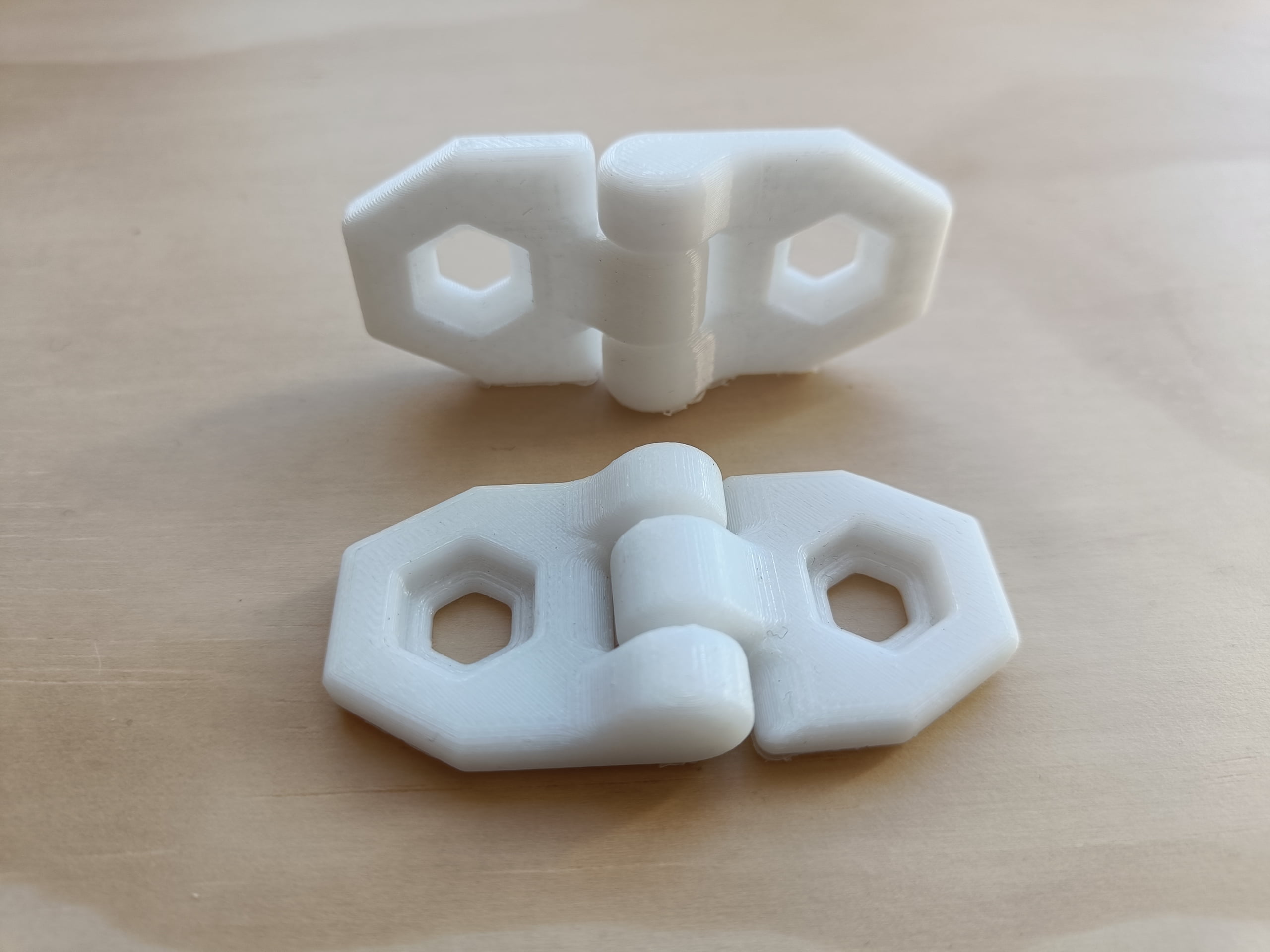

Okay, got a new Prusa MK4S 3d printer assembled, let’s get printing! :printer:

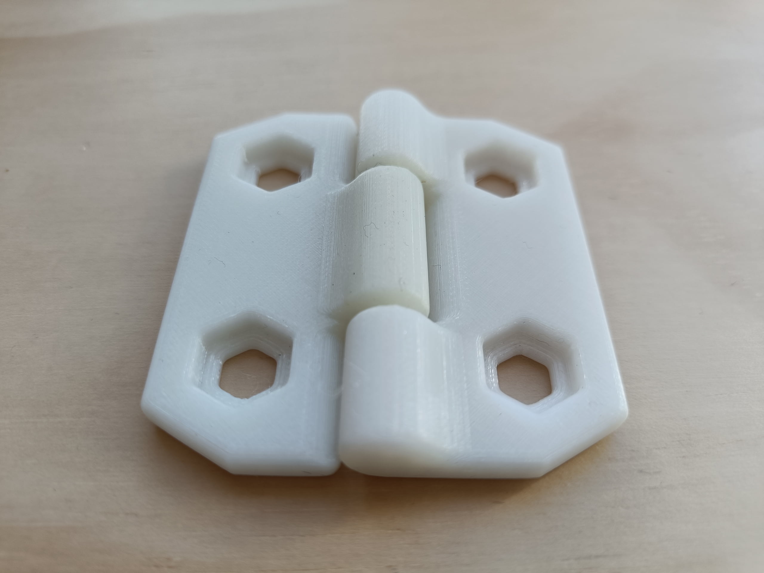

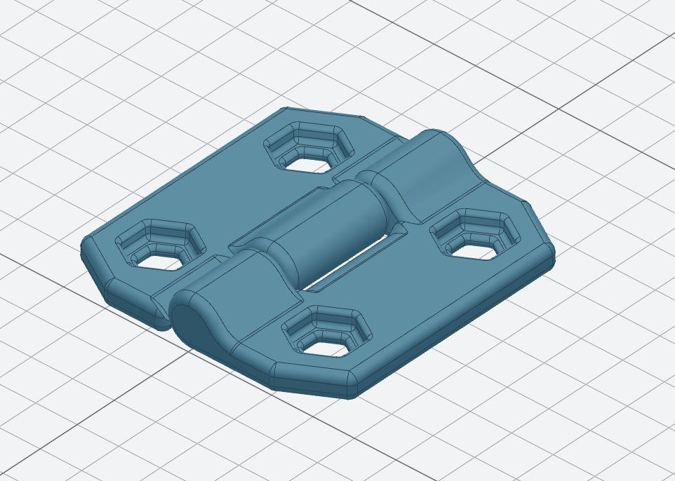

A 2-grid-unit hinge:

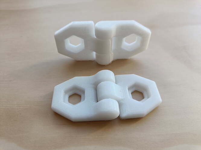

Two 1-grid-unit hinges:
  • one printed horizontally: to maximize strength
  • one printed vertically: to maximize hinge-smoothness

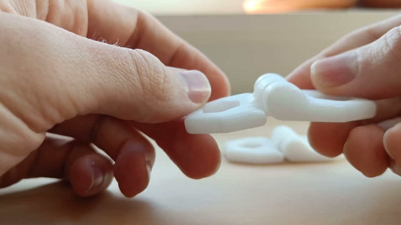

I also made a little video showing them off:

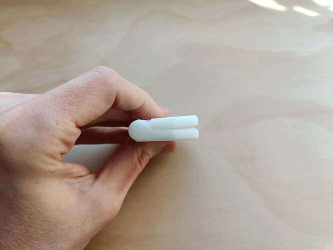

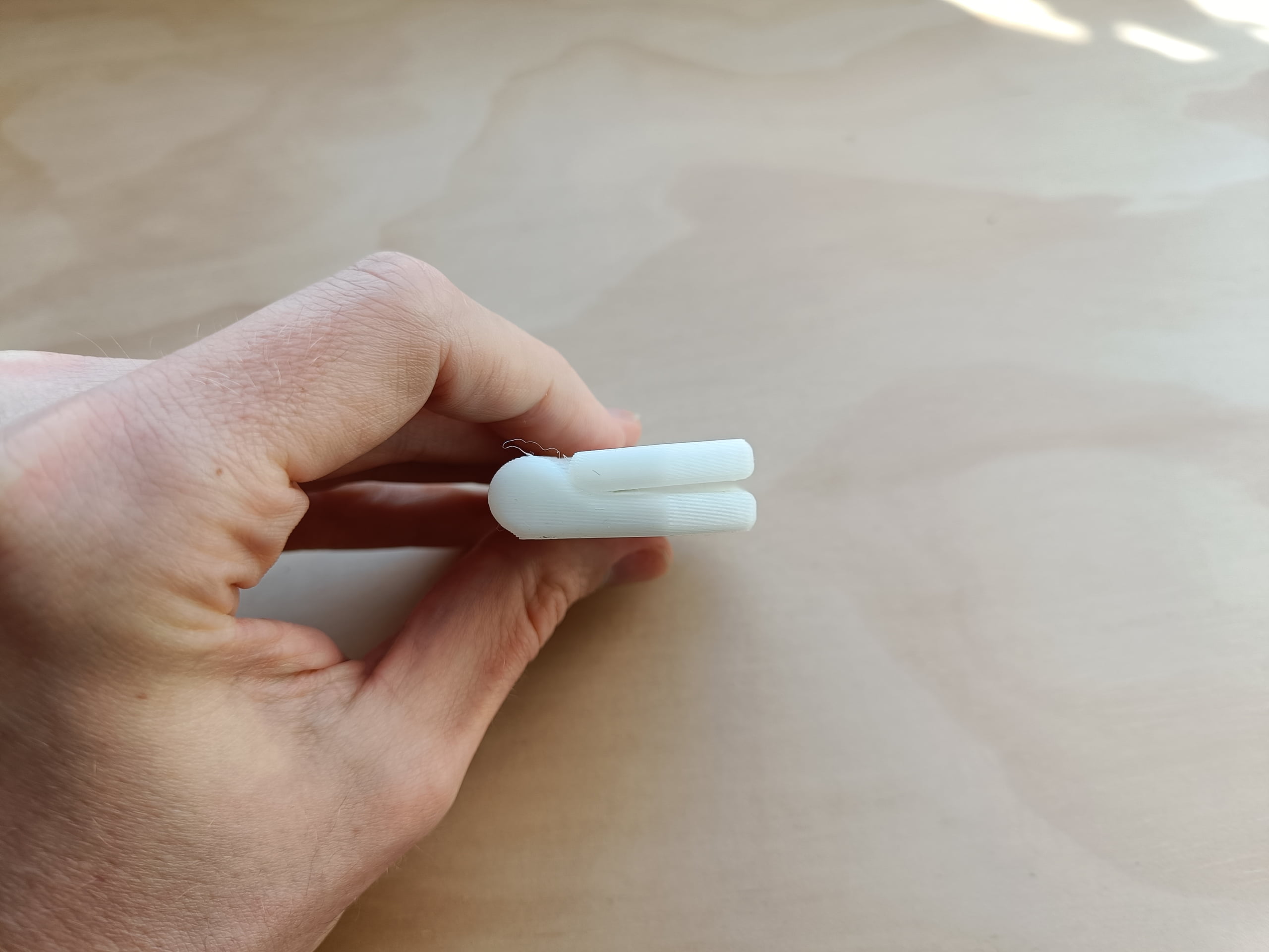

Oh also, I might need to update the design, since the butt of the hinge can’t close all the way. :peach:
