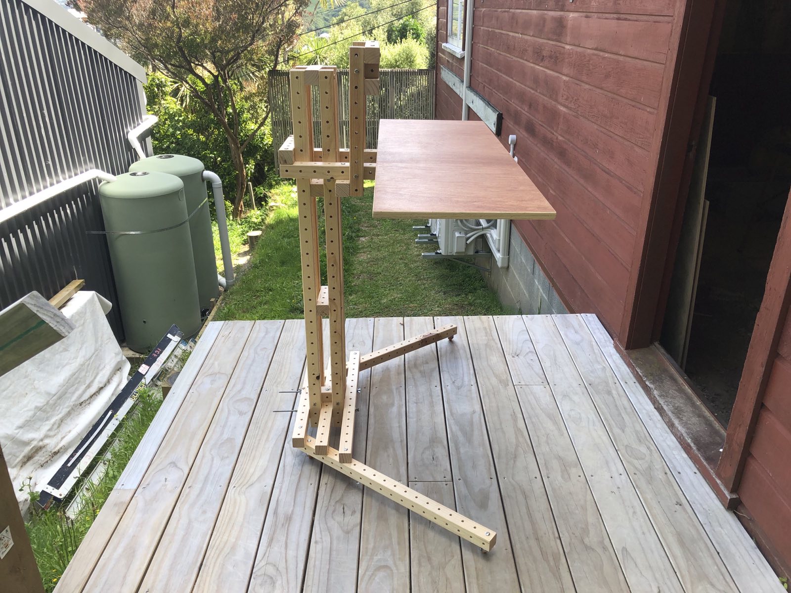

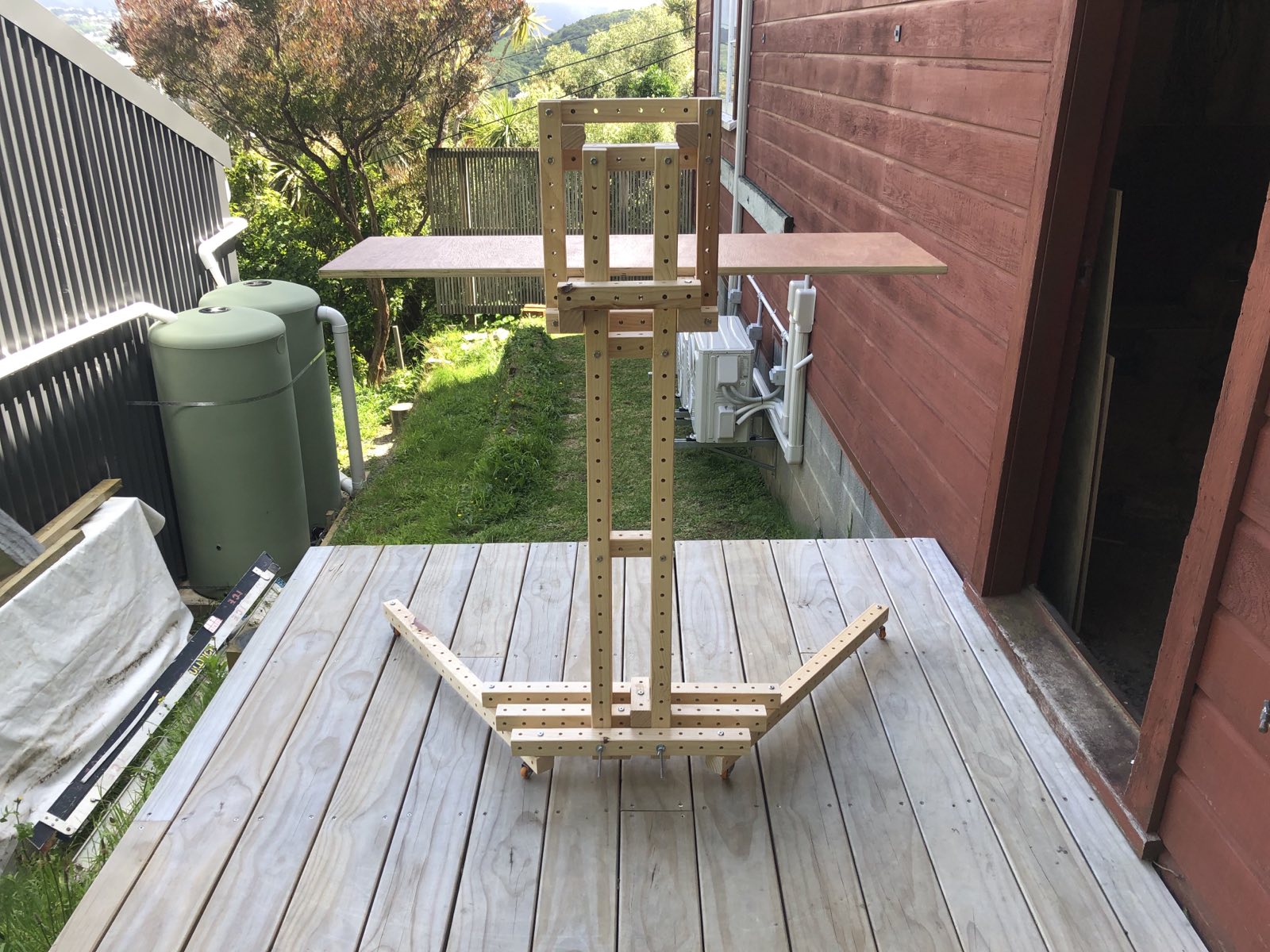

Had an idea for an adjustable standing desk, so decided to make rough prototype of it with the grid beam and grid panel that was lying around.
Basically, It uses the weight of the desk as leverage to hold the desk in Place. I think I’m going to come up with some type of clip to secure it.
Here’s some photos and a video of it so far. I will add more pic’s as a refine the design.
Let me know what you think?

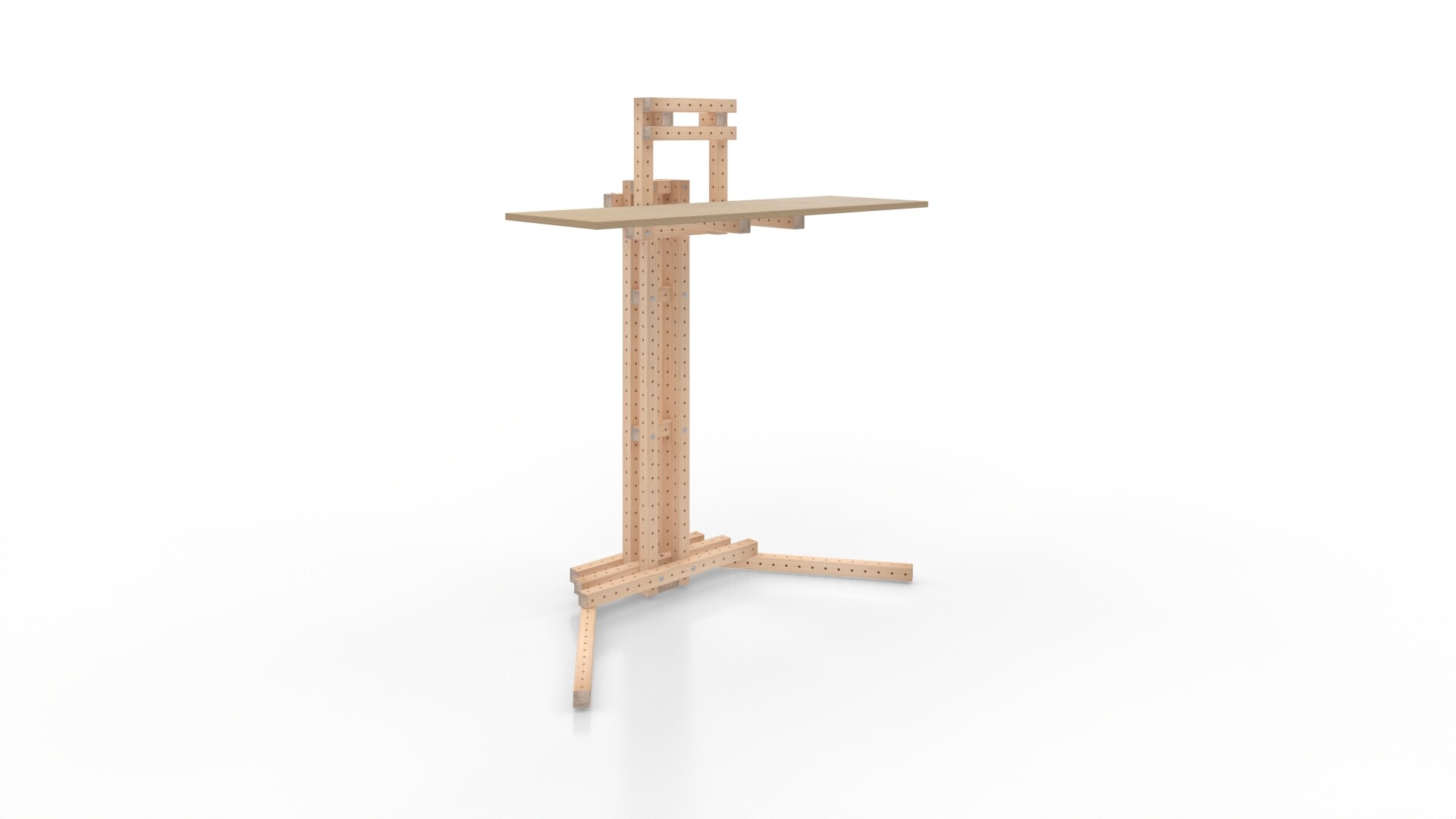

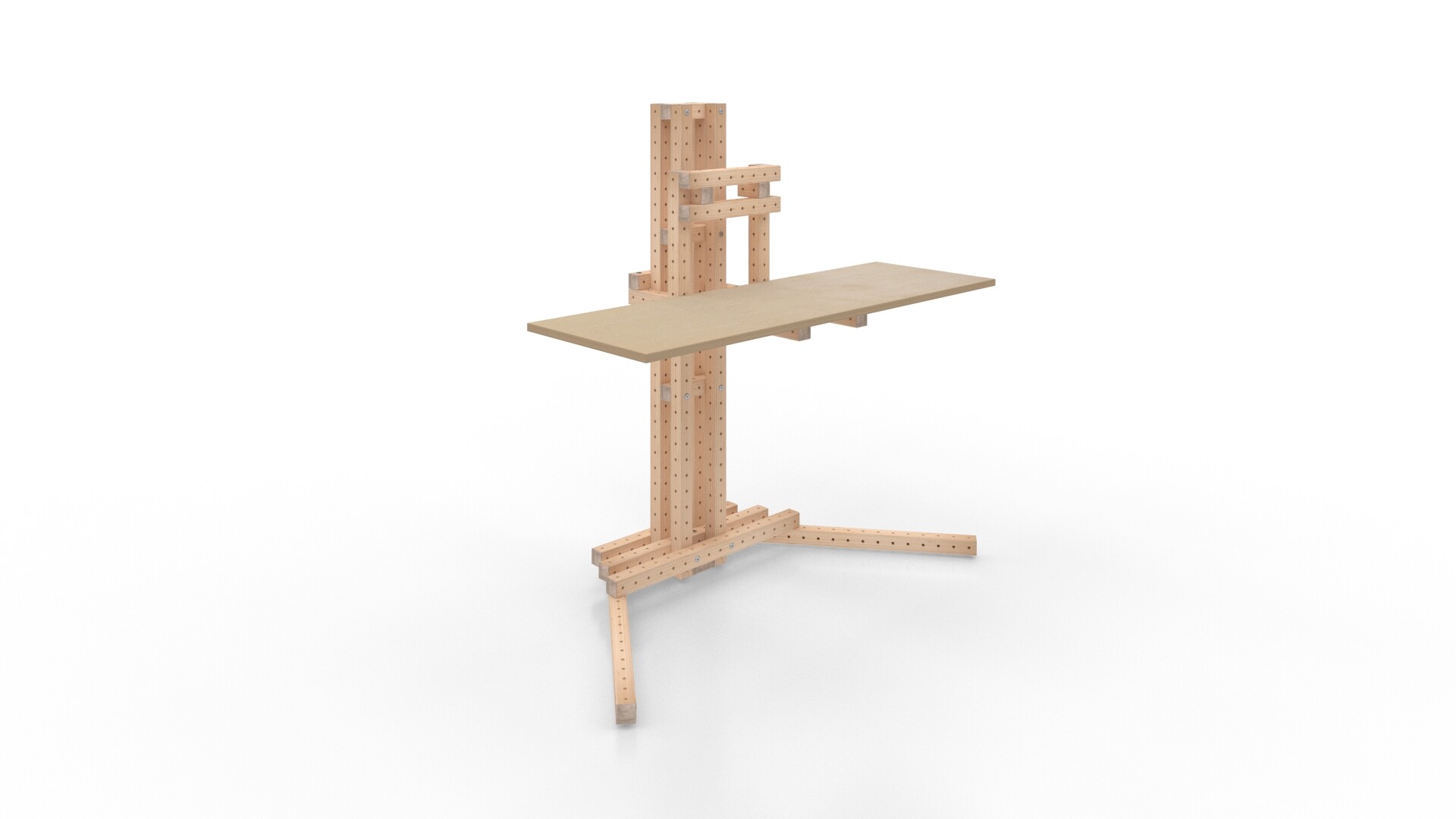

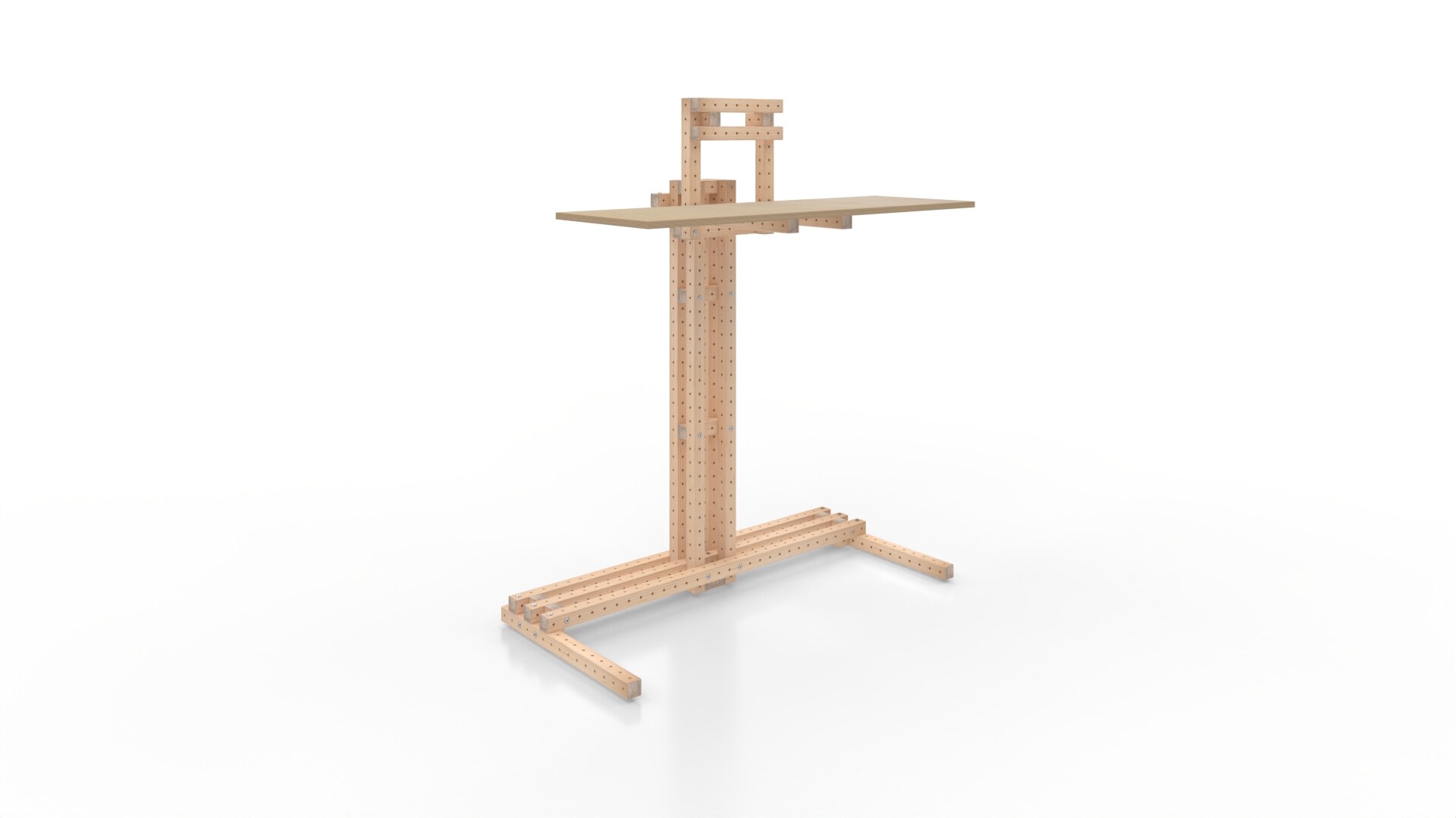

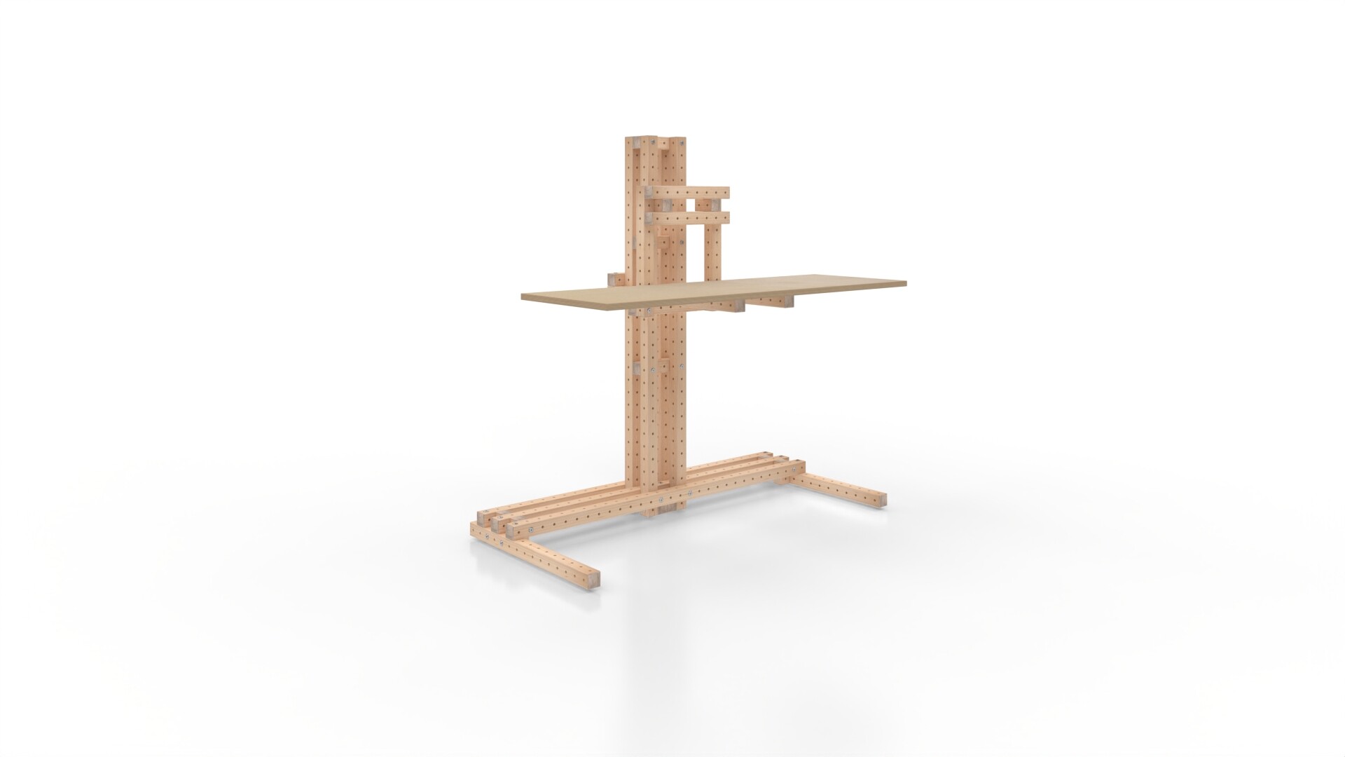

Worked on the design in Rhino, and have made a few improvements.
  1. I refined the base two possible options one with straight legs, and one with diagonal legs. neither are tested for stability yet
  2. attached the monitor stand to the part that moves, so that it adjusts auto-magically when the desk is adjusted.
  3. Beefed up the vertical column support.
  4. Added a place for a desktop to sit on the legs.
  5. It’s not in the render, but I thought about adding a weight on a pully to counter balance the desk when it’s adjusted. Kind of like weight machines at the gym.
I’d also like to try 3d printing a hook for headphones, and adding casters. Will give a go at building it in the near future. I need a new desk. :sweat_smile:

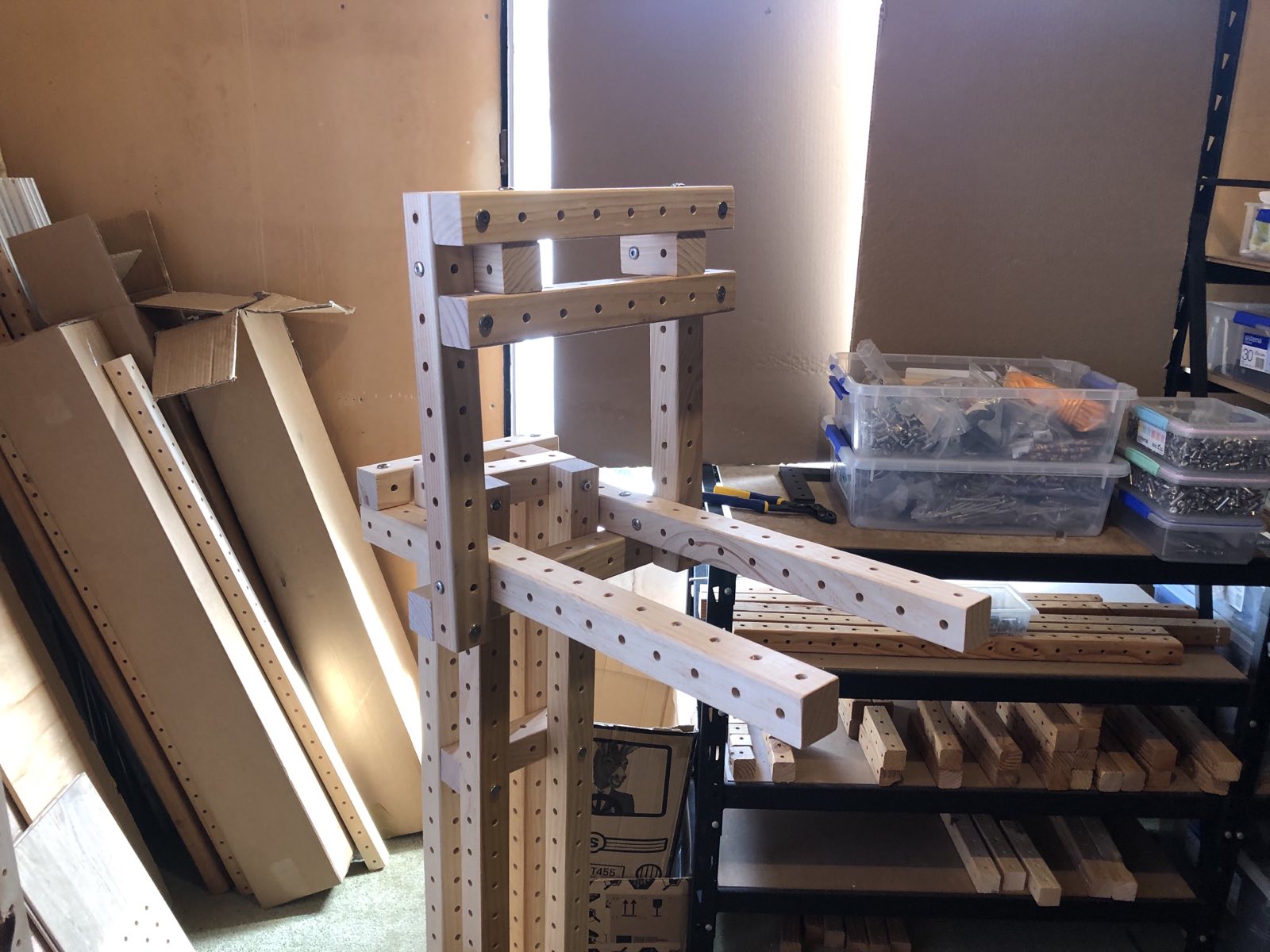

Finally getting around to building this desk. Real stoked with how it has turned out. I decided to go with the angled base as it used fewer beams. In total it uses 11x 30gu beams and 1x 30x10gu panels.
The build was pretty straight forward.
Used this 3D printed cut jig that accounts for the Miter saw kerf.
Gave all of the corners a sand with some 120 on a sanding block.

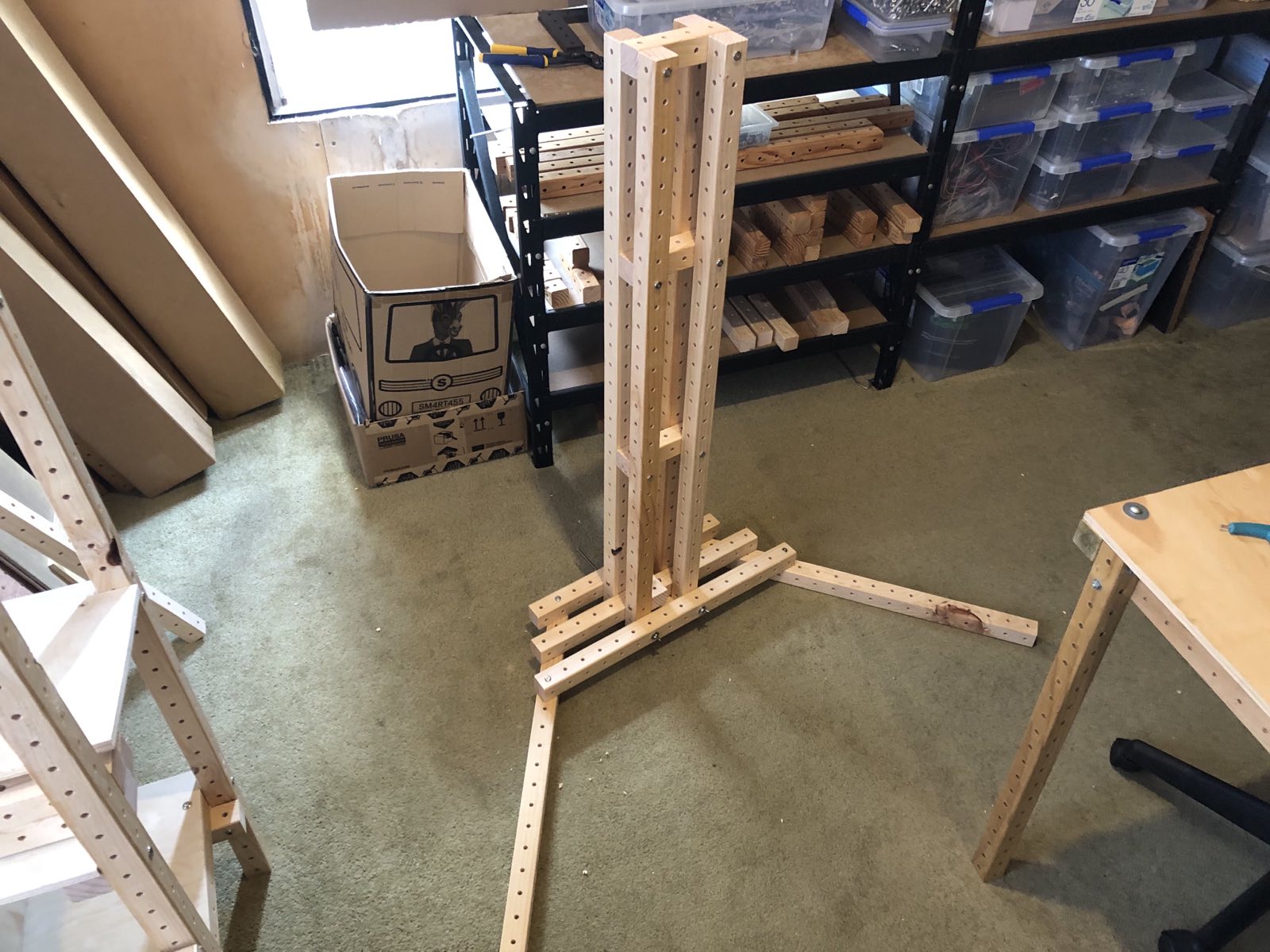

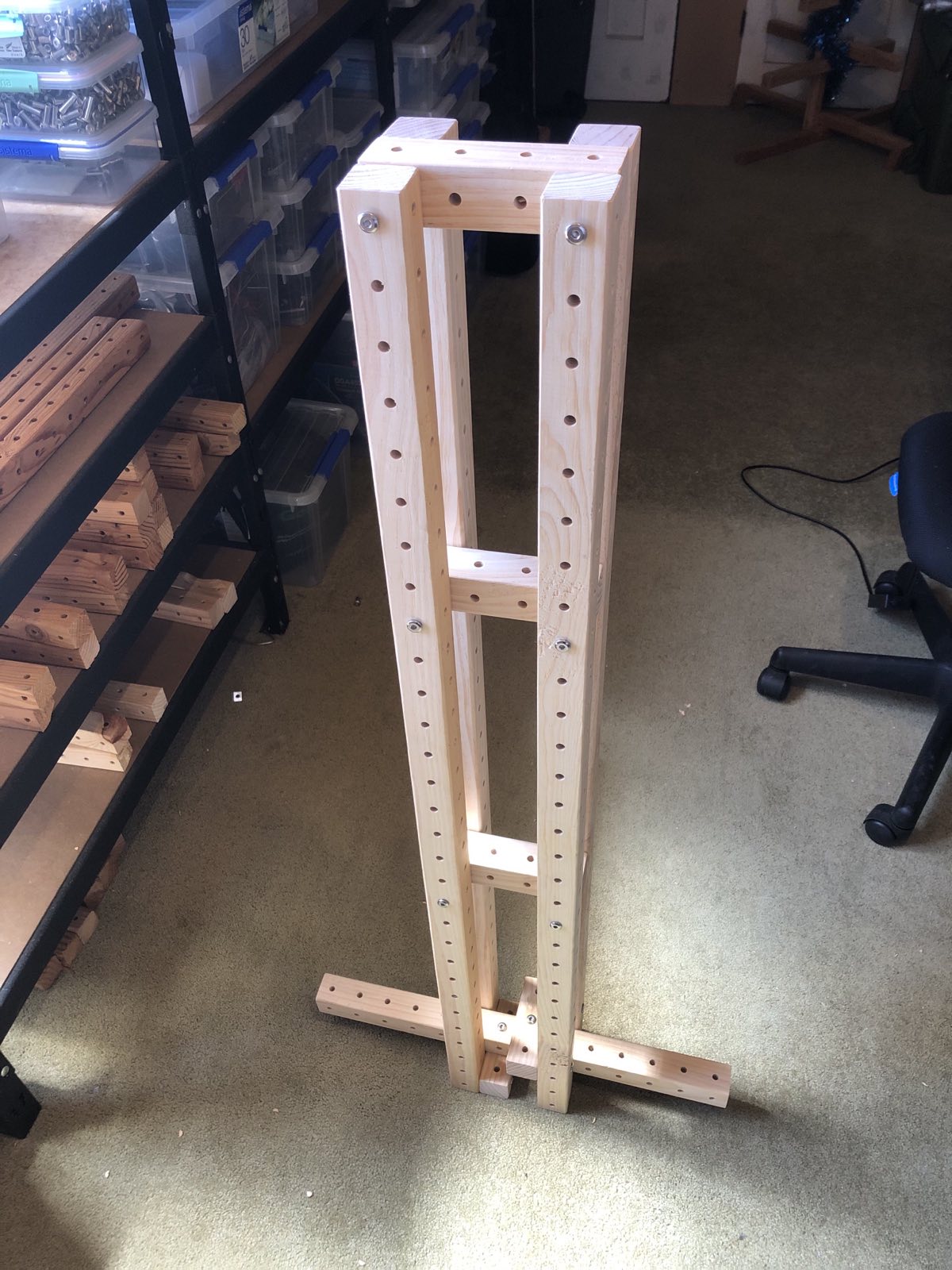

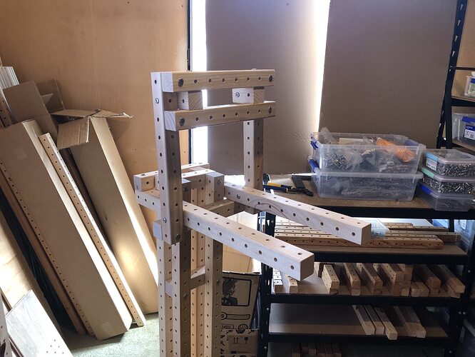

Then I started assembling the central column.
Then added the base. I needed a couple of threaded rods to connect the 5 beams across the bottom. Just used some wing nuts to tighten it down, and just left the threaded rods long for now. I really liked using the wing nuts, supper easy for assembly and has a nice look.

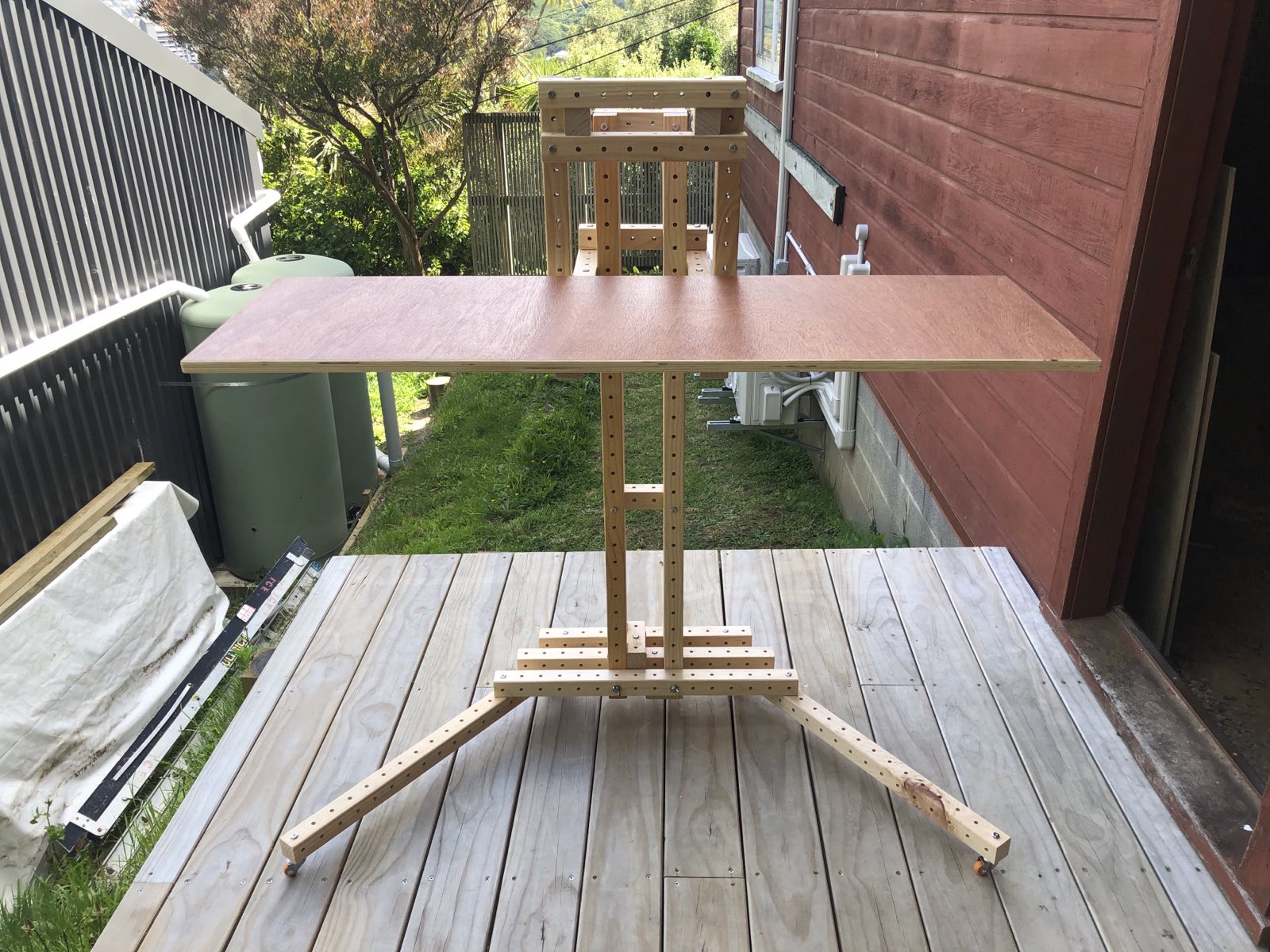

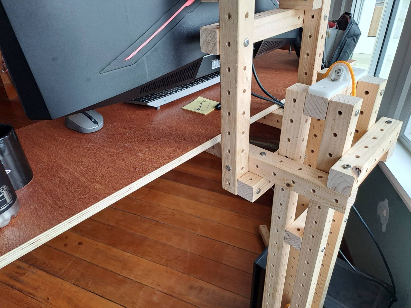

After I got the base completed, I made the desk part, which is completely separate from the tower. this is how it is adjusted. Basically the weight of the desk leverages against the column keeping it in place. Though I did put a couple of loose bults under it just incase it slips.
After getting it all assembled I realized the monitor mount is way to low, so need to extend that before I add my monitor to it.

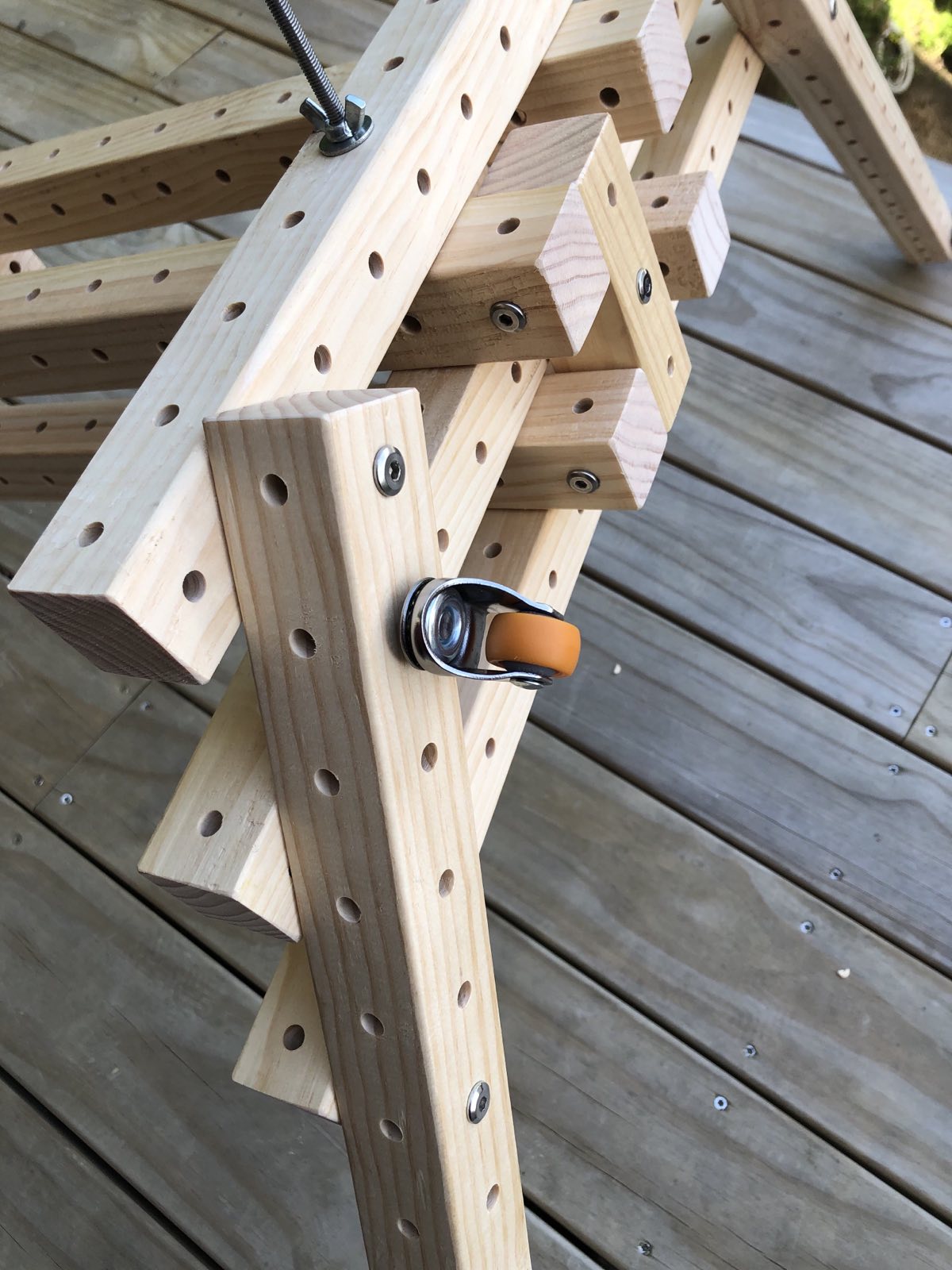

I put these little casters I got off Aliexpress and they are working great!
I was real worried it wouldn’t be stable, but it’s surprisingly stable. There’s a little wobble in the tower, maybe if I added some plywood the the sides of the tower It would increase the stability, but I’m happy with it as is.

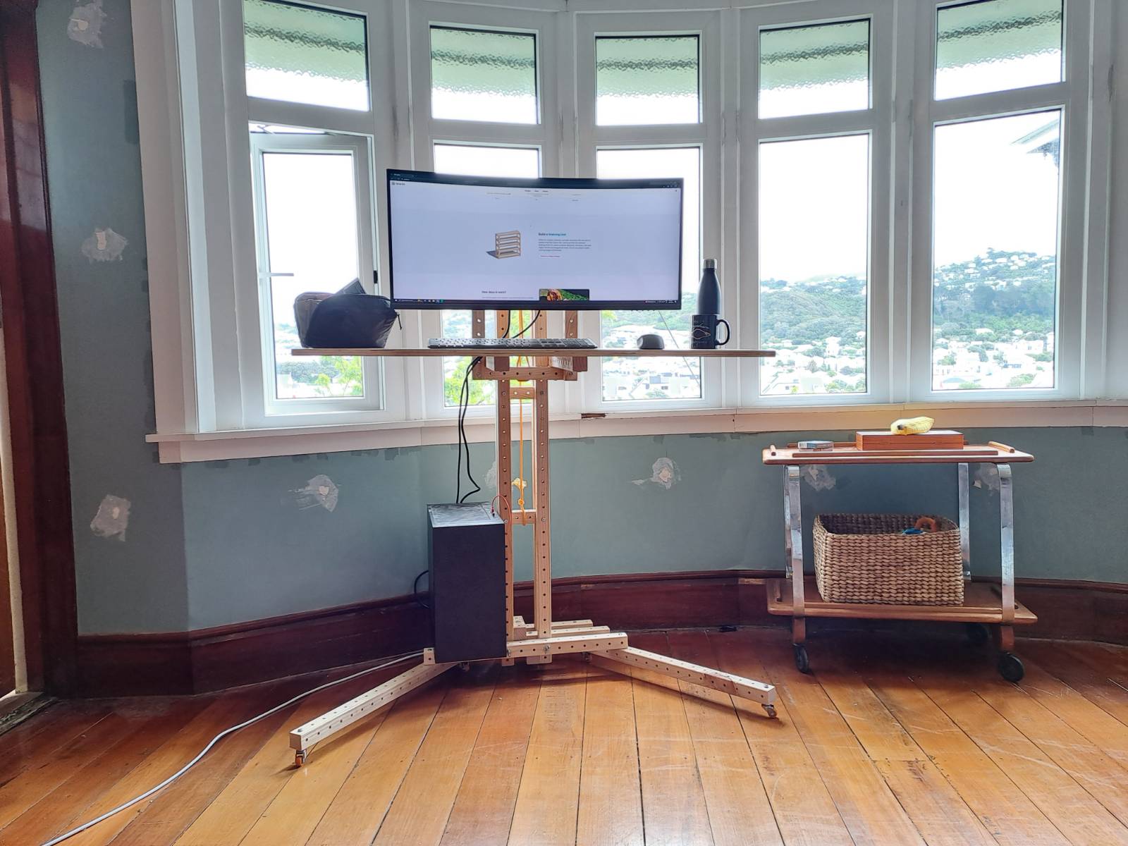

This is really cool @HonkyTonkRobot , how had it been working out? Be interested to know more about the “wobble” (is it side-side / front-back?)
Your design reminds me of something a friend of mine makes : Limber Desk | Physio-Designed Standing Desk
@mixmix Thanks! Now that it’s been in action for a few weeks, I’ve got a list of changes I want to make.
The wobble is more rotational around the column, Though It doesn’t really affect the use, it doesn’t inspire confidence either. :rofl:
