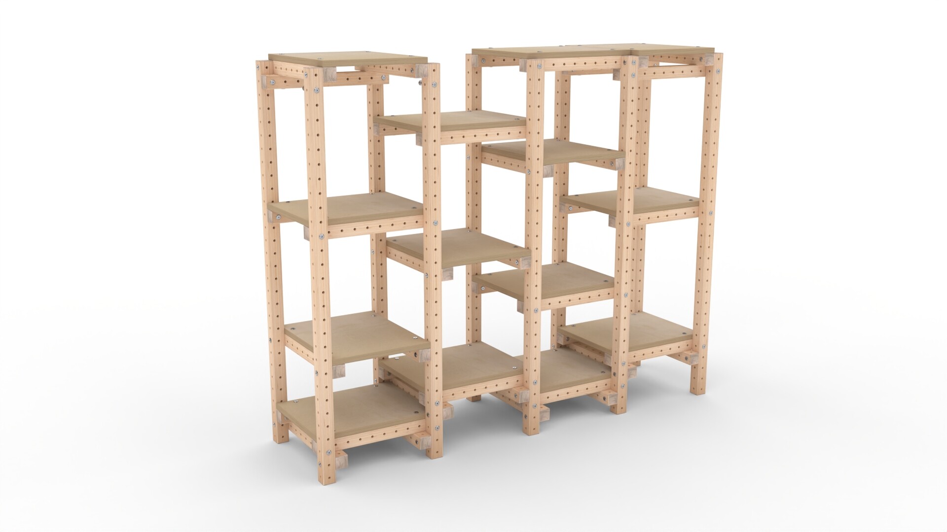

Working on an idea for a bookshelf with a path for the cat to be able to climb to the top.
The idea is the cat will be able to climb the book shelf starting at the bottom right climbing up to the left, and the other shelves will be filled with books.

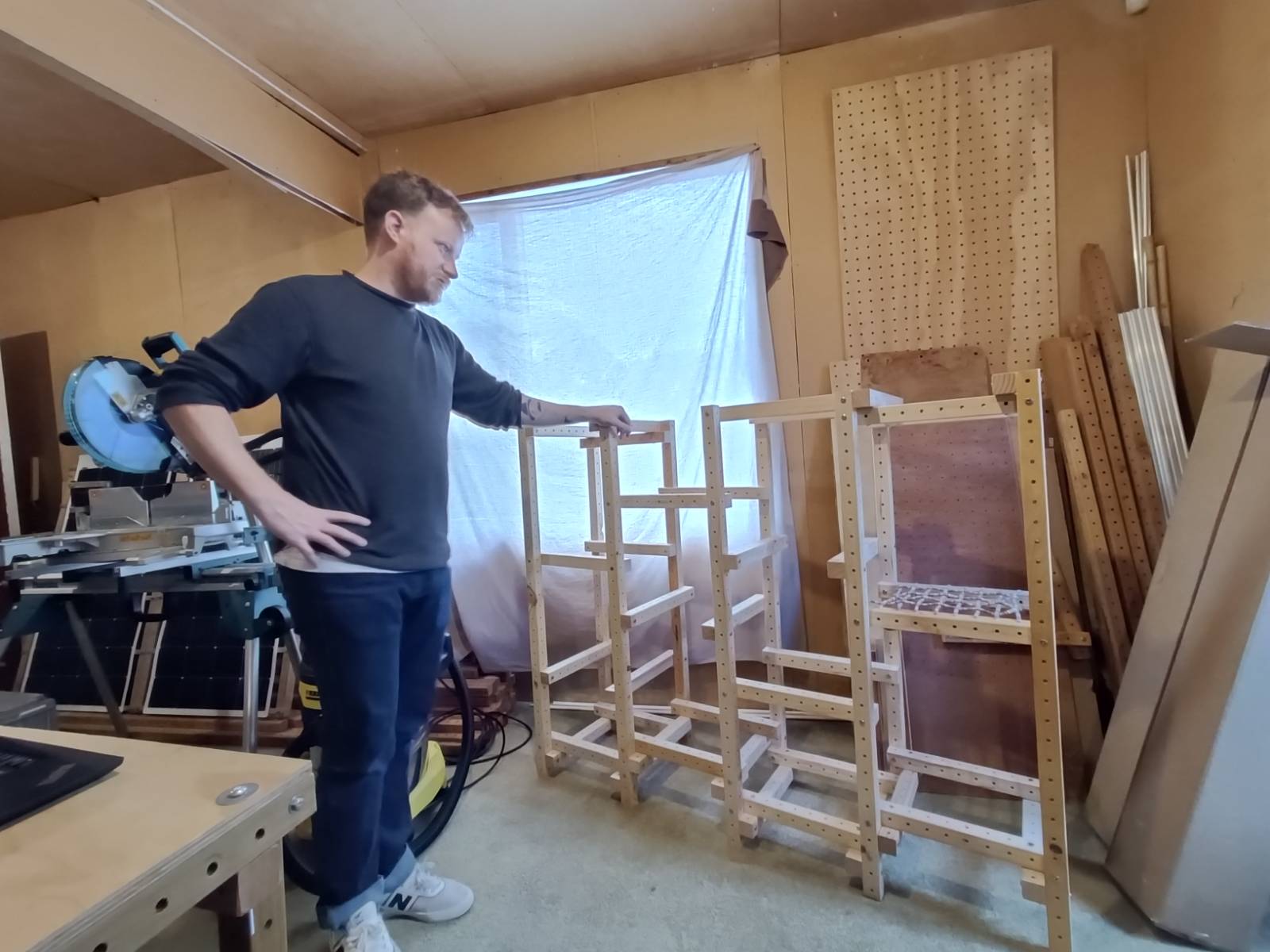

I’ve started building it, but still need to install the shelves. Just waiting on getting them back from the CNC shop.

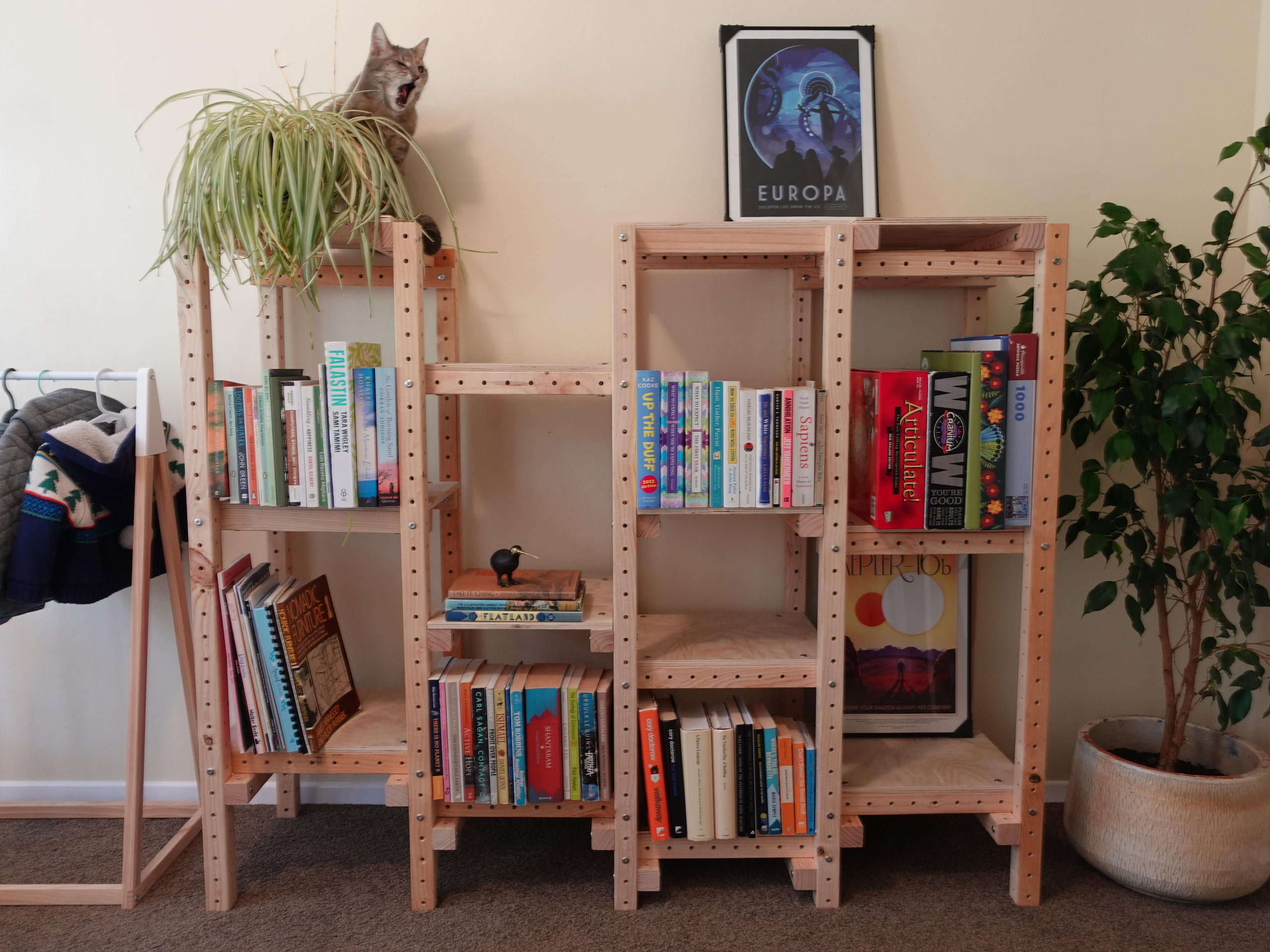

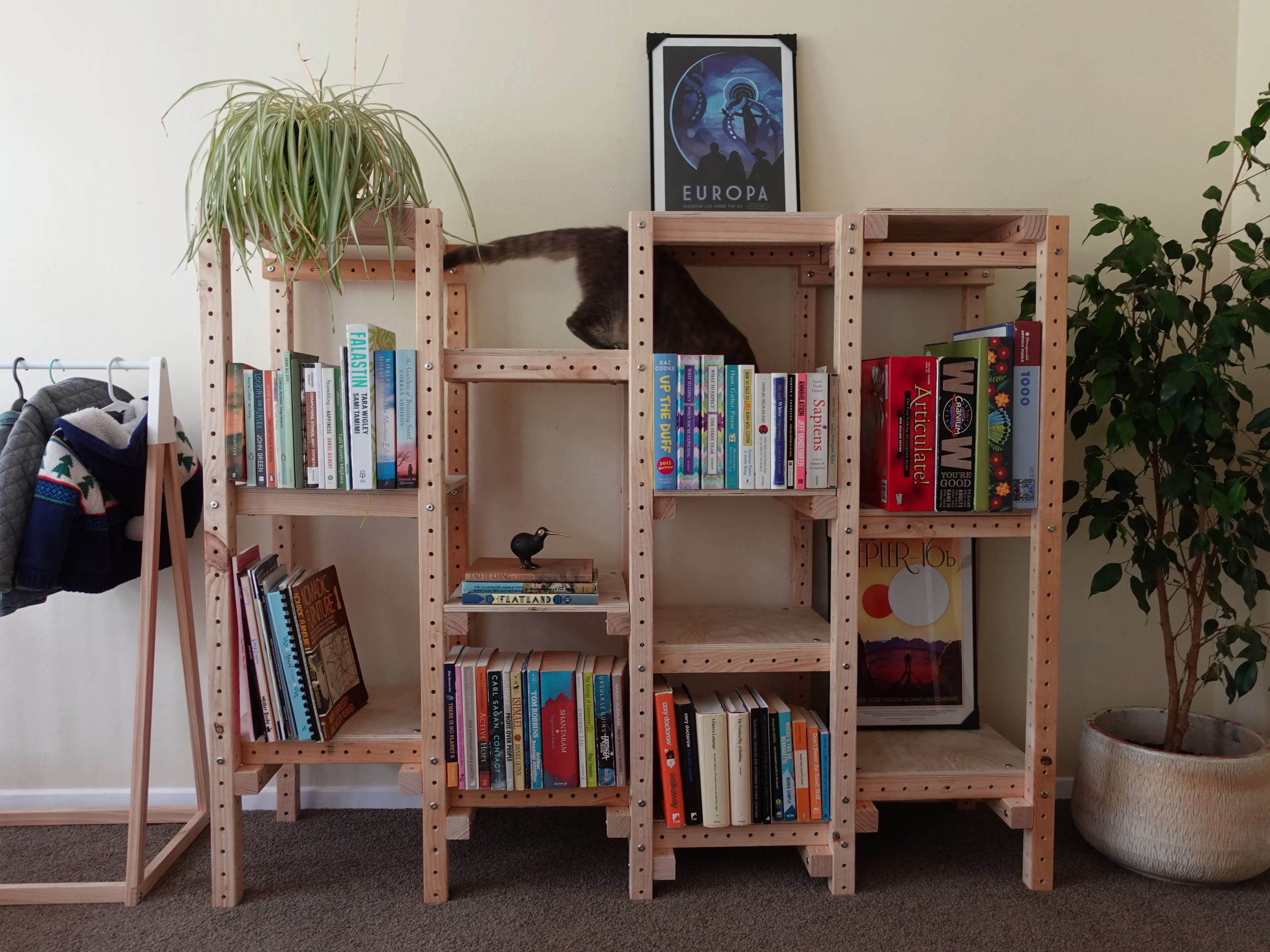

Here’s what the final product looks like with books and Cat.
