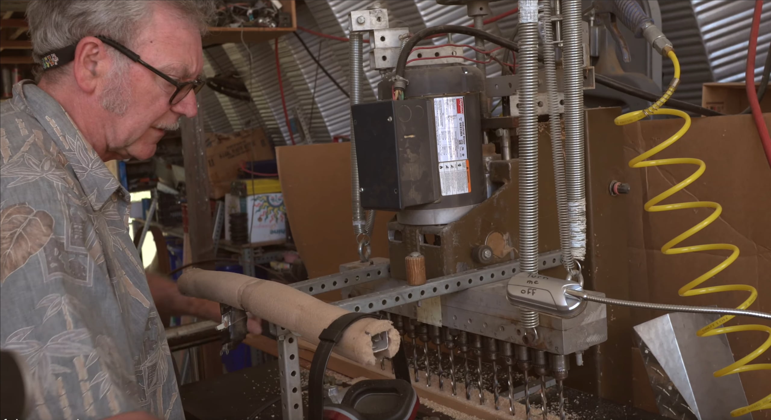

Super block gang drill.
An entire length of timber is fed into the machine and one block of drill heads come down and drill all the holes in one hit, one drill head per hole.
Inspiration:
Pros - fastest machine, holes always aligned (at least on one axis)
Cons - need a lot of power to drill all at once, expensive to make machine
Indexing block gang drill.

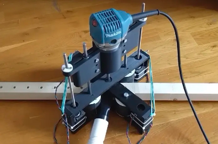

Rolling through feed drill.
The timber is fed by driven rollers through a drilling station that drills each hole at the correct location. Possibly in conjunction with a gang drilling head.
Inspiration:
https://www.indiegogo.com/projects/beamcnc-construction-system-cnc-mill#/
Pros - fast, tiny, could use many at once. if encountering a knot in timber could adjust spindle speed.
Cons - misalignment possible

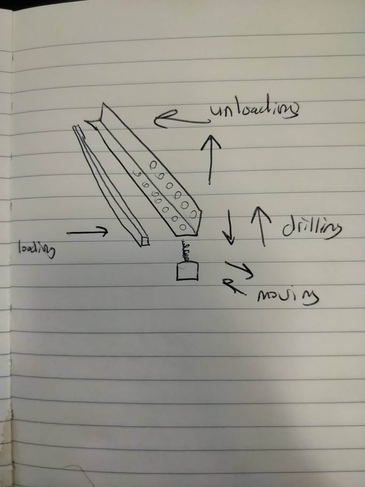

Grid Bot: Functional Blocks
Loading
  • Pick up and place on track from a distance
  • Rotate onto track from gravity-fed slanted tray
  • Multiple chains with tabs push beams onto track
  • Beams fed vertically down onto track. When the beam moves out of the way a new beam drops down.
  • Conveyor chain lifts from gravity fed stack
Clamping
  • Many diagonal v-profile clamps push down beam against fixed wall/floor
  • Single long diagonal v-profile with cut-outs for drills clamps against wall/floor
  • Rollers push down and horizontally
  • Centering sprung rollers pushes both sides in, rollers keep down
  • Clamp comes down between spindles and pulls down and in towards track
  • Clamp methods: pneumatic cylinder, manual, …
  • Two separate Clamps come for vertical and horizontal
Moving
  • threaded rod on track with clamps attached
  • End pusher pushes until force sensor at end detects force
  • With beams clamped to “table”, “table” moves along fixed “bed” using stepper motor powered linear actuators (threaded rods), thus moving the beams
Drilling
  • Location
    • Spindles are static above, table moves up
    • Spindles are static below, table moves down
    • Spindles are horizontal, table moves into spindles
    • Very rigid clamp moves the beam into spindles, no table!
Flipping
  • Tumbling
  • Don’t actually flip them, just run them through the machine twice
  • Don’t actually flip them, just run them through the machine four times!
  • Pick up the ends of the beam by the corner so that it rotates 90degs, re-clamp.
  • Clamp can rotate?
Unloading
  • Spit out onto the ground
  • Pushout onto a long angled roller track. They roll down and stack up in a line.
  • Pushed out onto track, bumped off into a bin on wheels
  • Push back through holes in the fixed fence
  • Rotate out with dynamic right-angle arm
  • Lift out and dump with a chain-driven bracket
