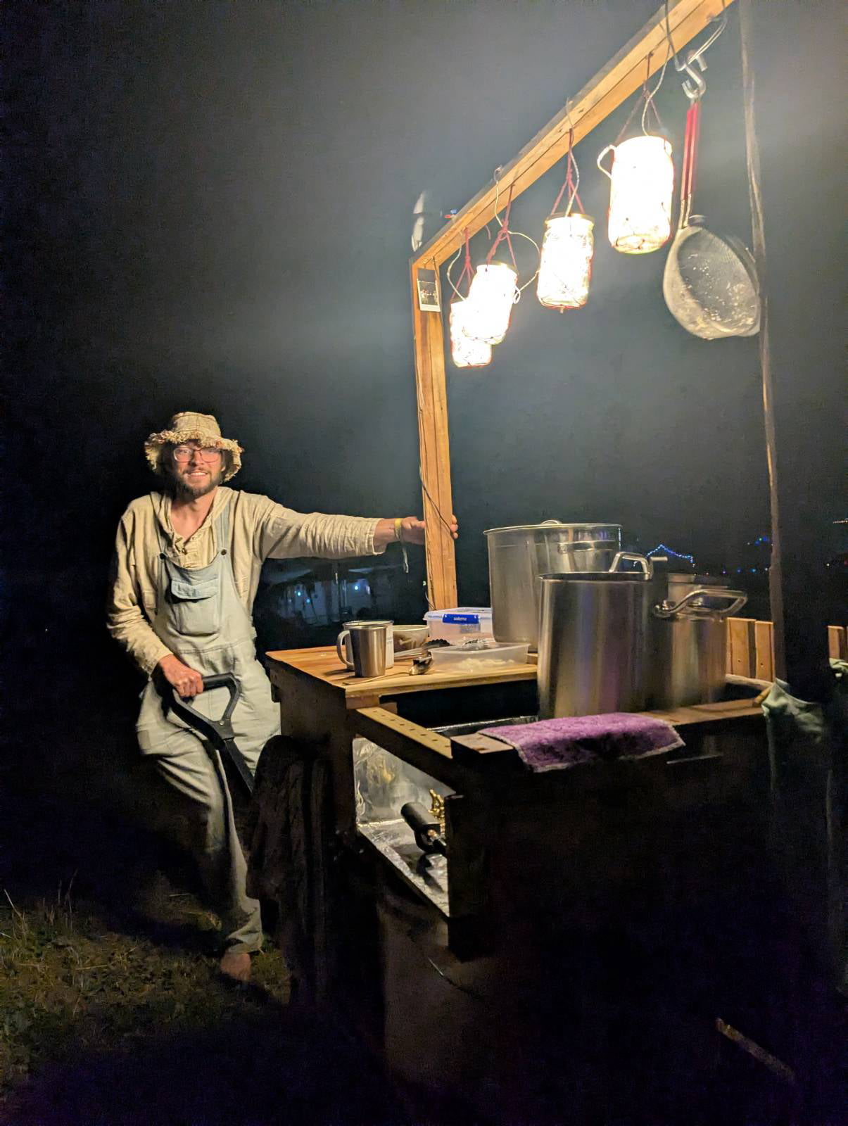

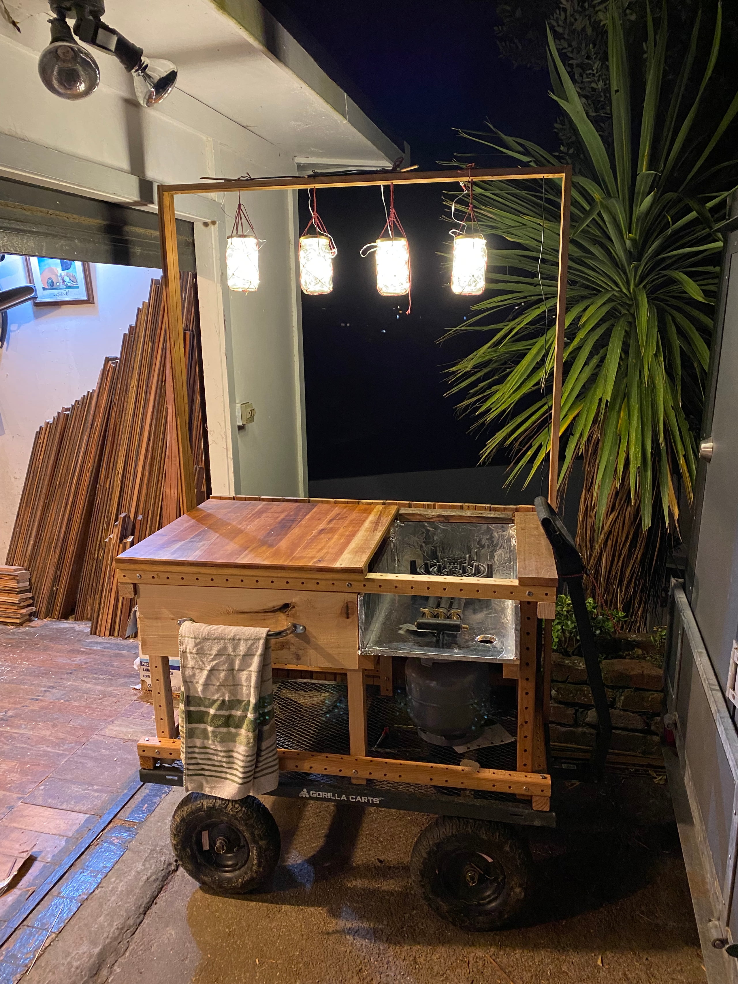

I had an idea that I would like to create a food cart, using recycled materials to bring to Kiwiburn. Ramen is the food I am best at making so It was the goal that guided the design. The design was built to mount on a flat bed garden cart which means the frame pieces can be used for other portable designs.
- Recycled T&G Matai front panel for a rustic feeling
- benchtop made also from the same but trimmed, joined finished and mounted with insert nuts
- Soft close drawer, drawer runner adapter panels made for specific grid unit depth.
- heatproof trough drawer for housing the gas cooker.
- over head gantry for hanging lights with custom hacked 5v fairy lights to use USB power.
