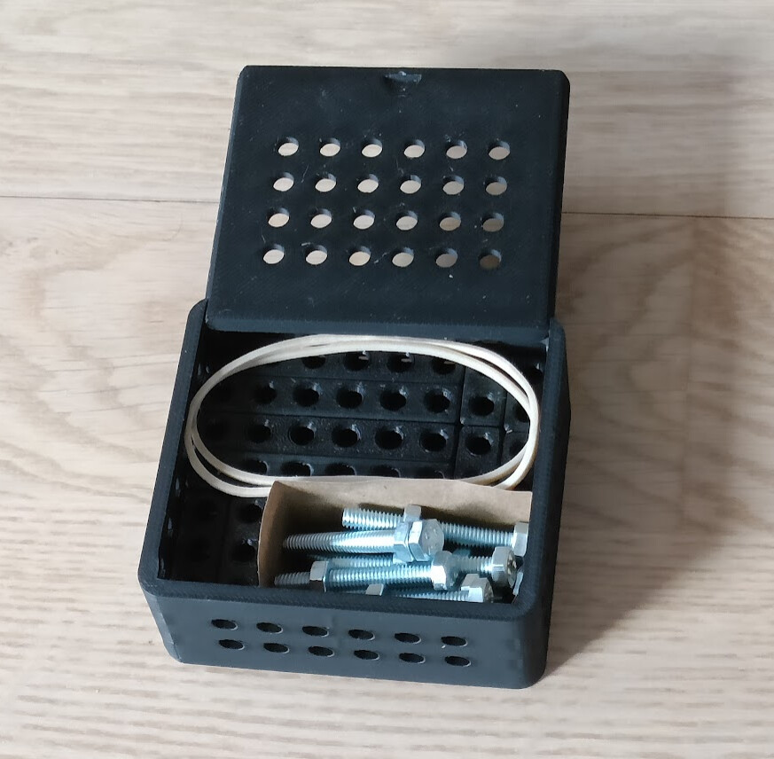

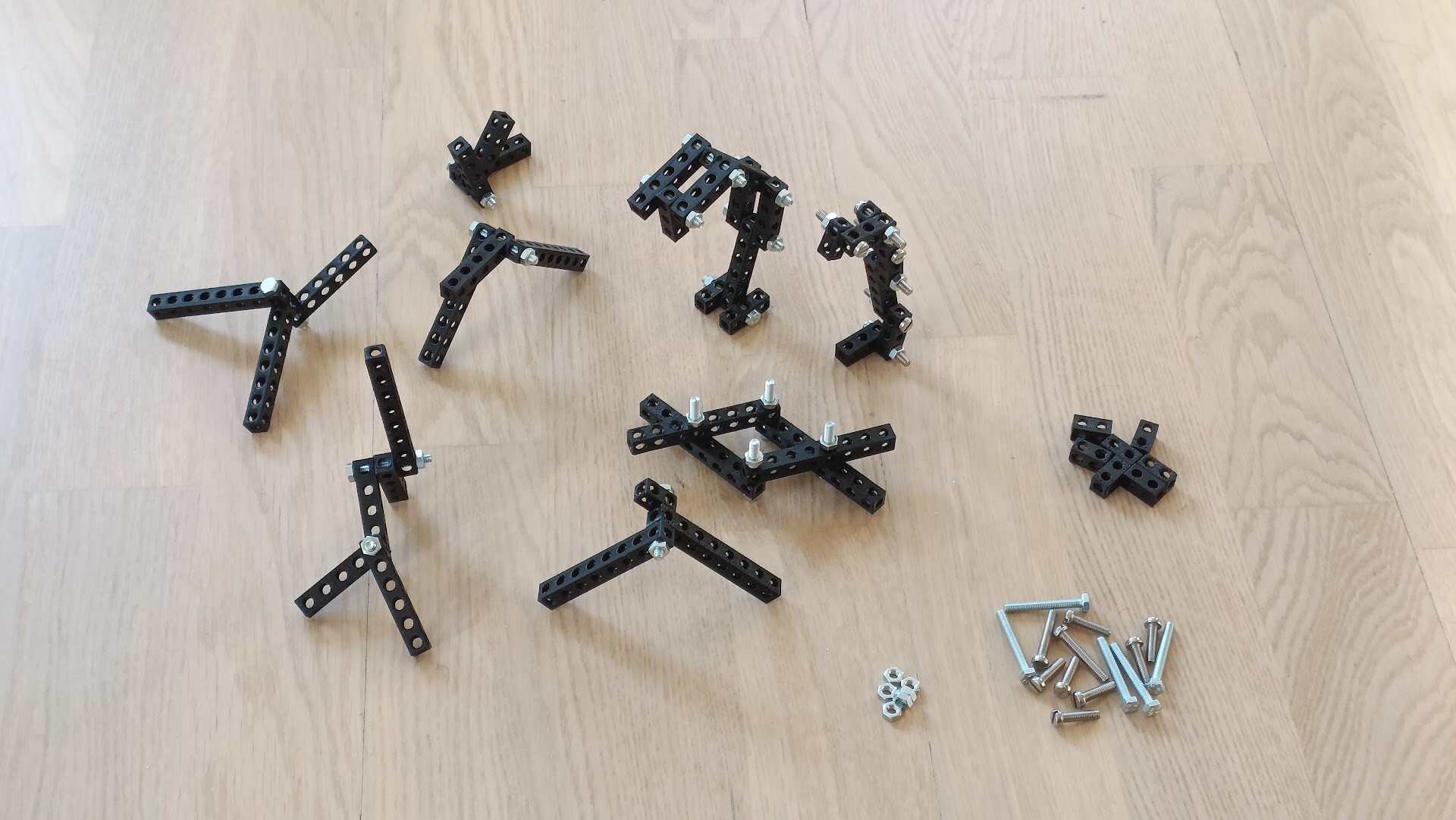

I am running a robot summer camp in a few weeks and using 3D printed grid beams for the structure and mechanical components. The beams have 8mm and holes of 4mm, I use M4 screws and it feels really nice.
You can have enough rigidity and clamping to do some interesting desk tools and some serious and not so serious mechanical contraptions! I have never built with real size grid beams, so I don’t know if it’s good for prototyping on other scales :slight_smile:

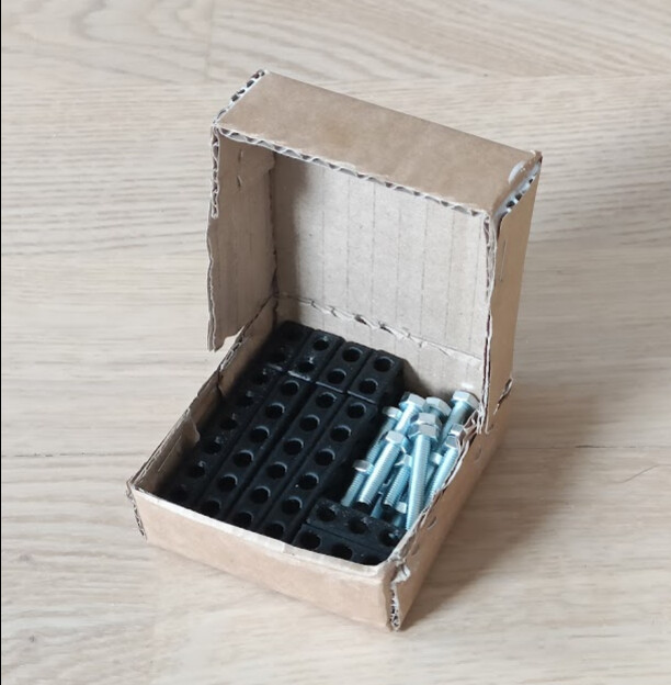

But with the little ones, a little box like this goes a long way.
The robots are coming out great and I wanted to share the 3D printed models with some friendly and experienced grid beam builders! I plan to do a replicad version of it (thanks @mikey for the link!) but for now this is what I’m using:
