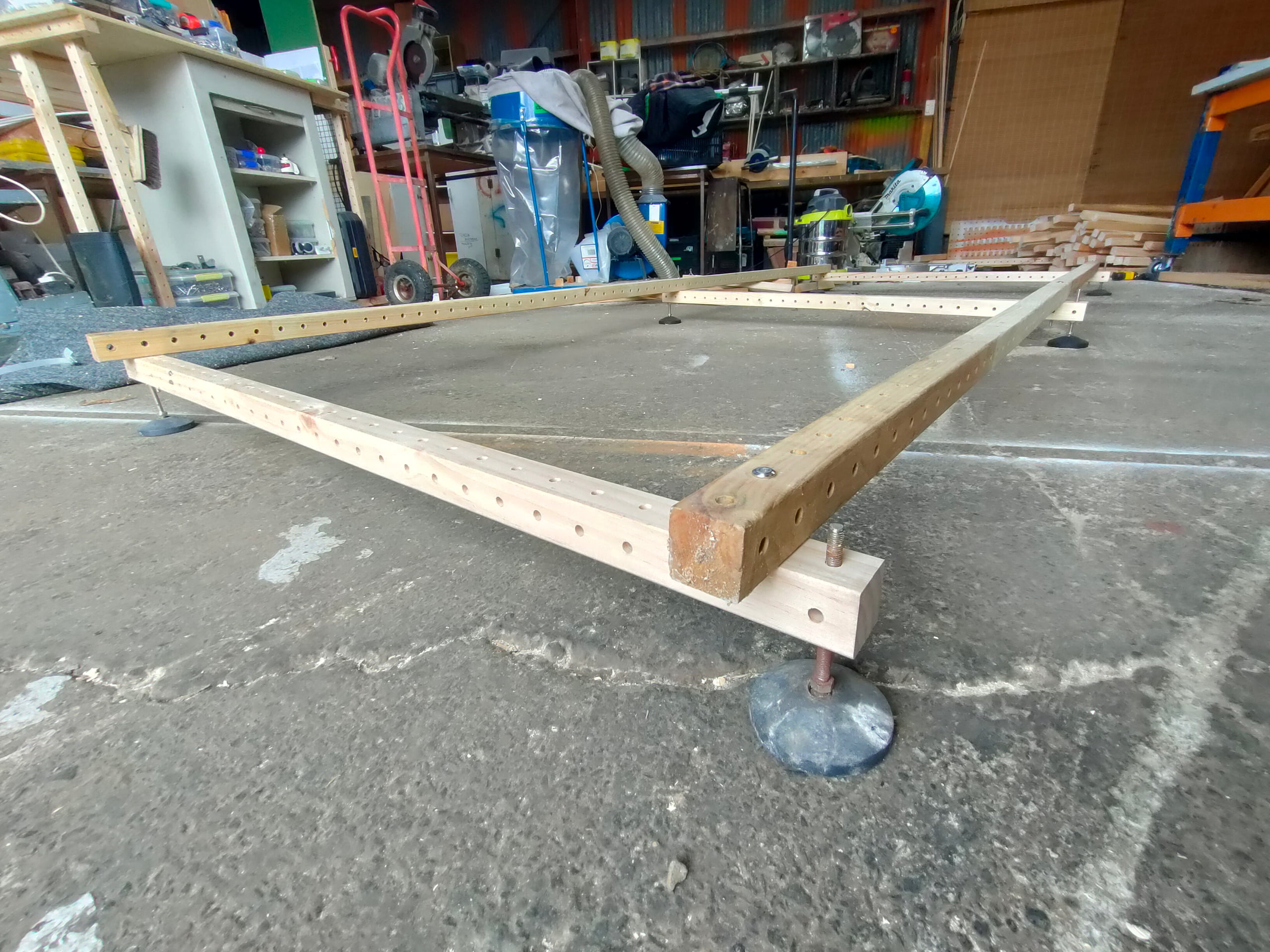

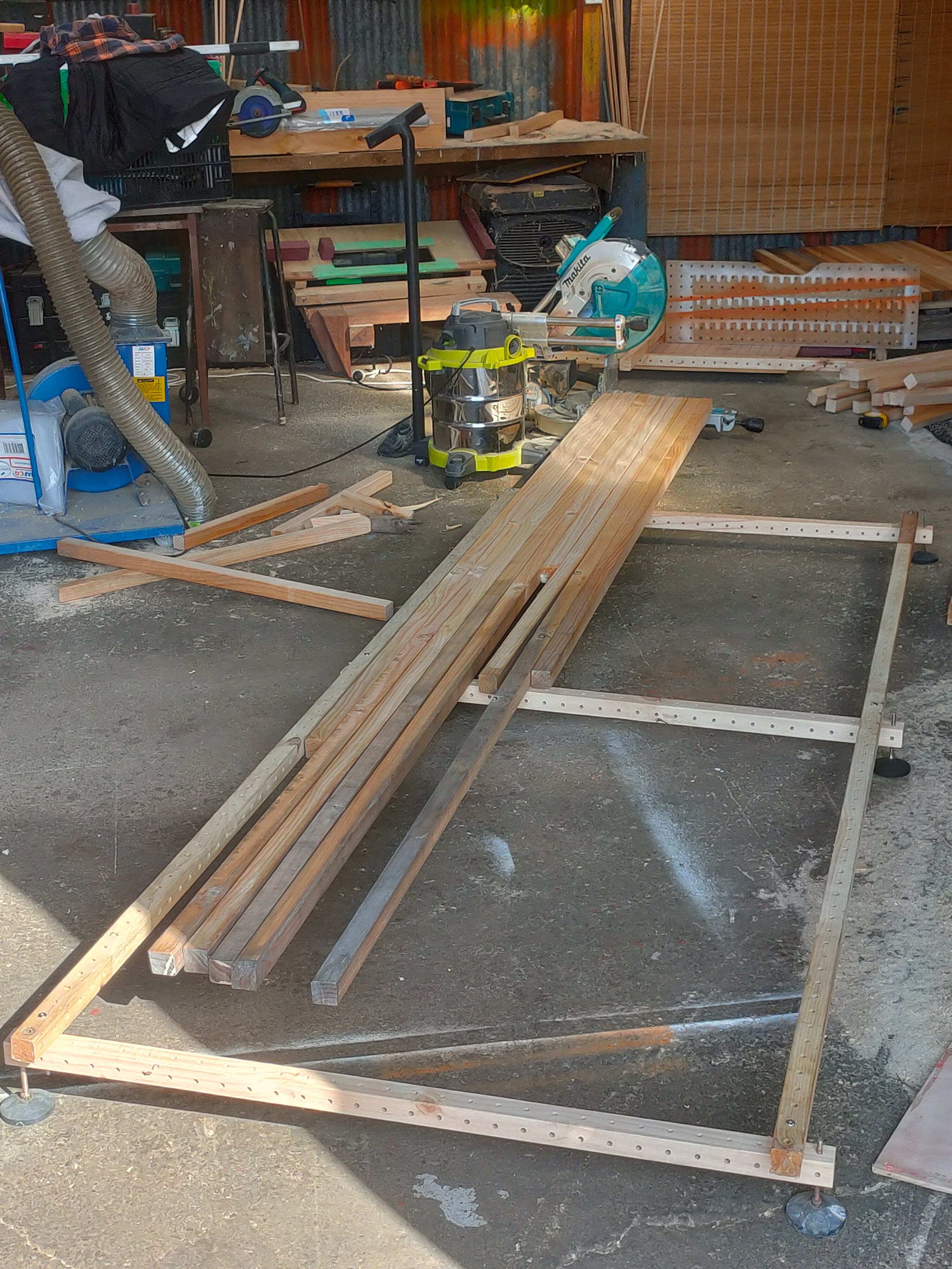

While cutting beams to length before they go into the hole drilling machine I needed something to help align the timber to the saw as my workshop floor isn’t level at all.

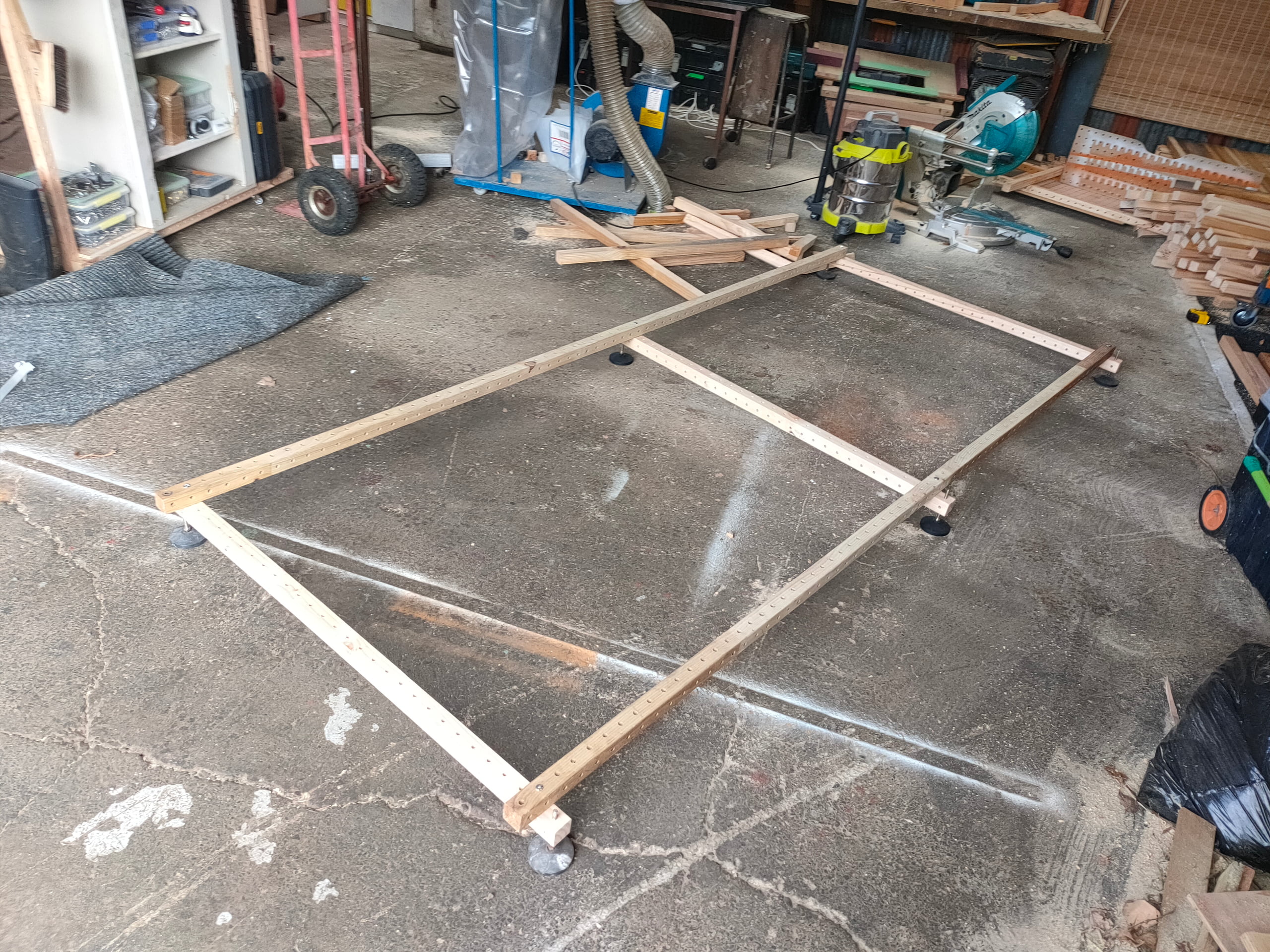

I devised this low platform with adjustable height feet. It worked really well and was quick to make and unmake ![]()
A small laser Level was used to quickly get the M8 threaded-rod foot heights adjusted.
