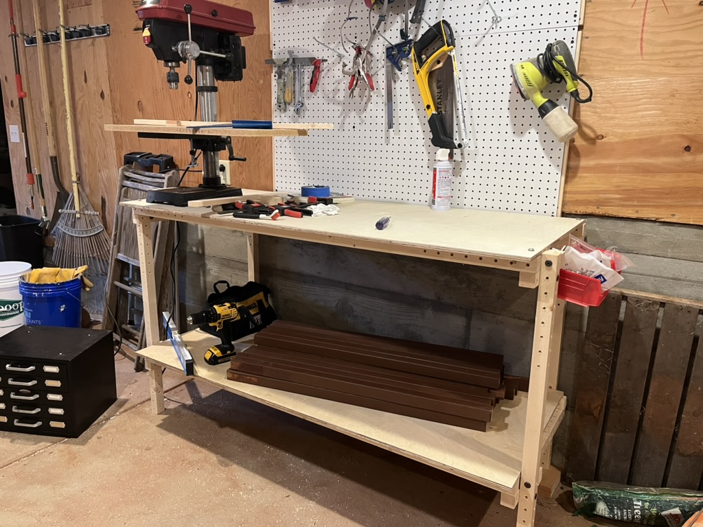

- A workbench, made basically according to the Grid Kit template and the first project in the Grid Beam book. I made it with an offset frame to avoid cutting notches in the plywood. This was made out of cheap construction-grade 2x2s, so the wood has dried out in the year since I made it and I have to tighten the bolts every so often, and I wish I had used 3/4" plywood instead of 1/2", but it’s been very useful.

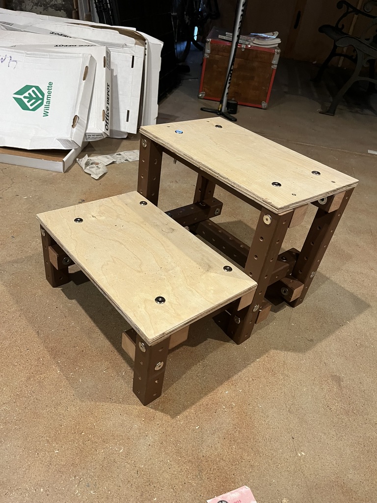

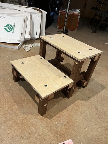

- A stepstool for my old dog to get onto our couch, using this GridKit template. This was made from a bunch of painted redwood balusters that someone gave away on Craigslist. I’m in California, which is prime territory for scavenging lumber online.
